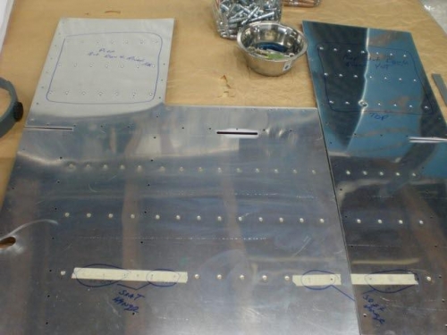

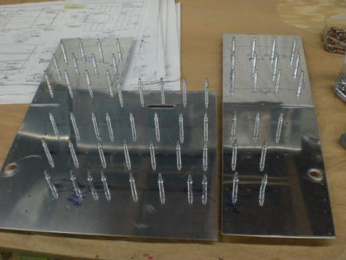

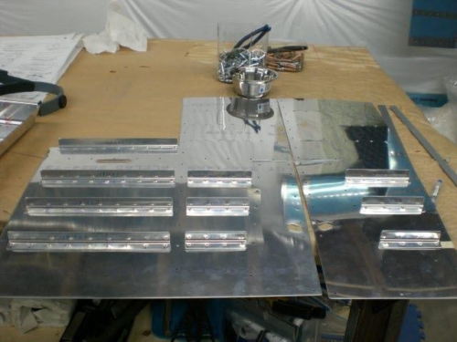

So with the major part of preparation comlete it was time to get to riveting. I still had some dimpling to do in this work session. There are some holes that will be used to hold the rear seat hinge so I had to be careful to tape off those holes so I would not prep them the same. After getting everything all set-up it was a breeze as I was able to "back rivet" all the stiffiners on to the panels. More parts completed.
The last three days have really been a wonderful time of getting work done on the project!!!
Cleco
Cleco
Dimple
Dimple
Rivet...done!
Rivet...done!
