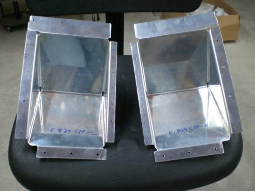

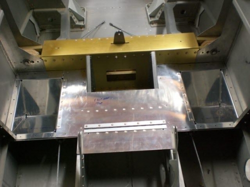

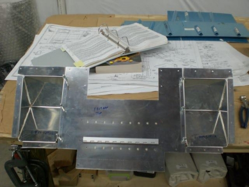

I was able to to complete the deburring and assembly of the footwells. A couple rivets were a little more trouble to get to, but nothing that an innovative back rivet setup couldn't do a nice job on! So the F-829 Left and Right footwells were completed. Next I clecoed them to their positions on the front floor skin and drilled, deburred, dimpled and riveted them in place. It's a process for every segment....it came out nicely horray.....now on to the rear floorboards!
Foot wells riveted
Foot wells riveted
Foot wells riveted to skin
Placed in airplane...perfect!
