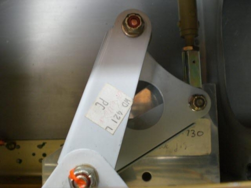

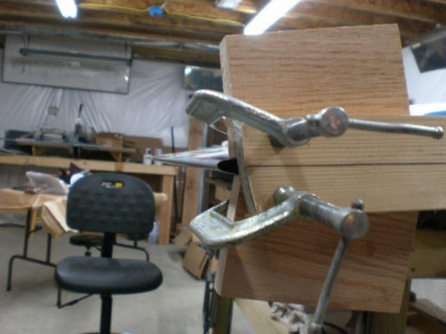

Brief Description:  Aileron Bellcrank initial alignment
Tonight I used the aileron alignment tool in order to set the rod ends at the right length. I split the dfference so each rod end is threaded into the control rod very close to the same depth. Not a hard process and really the most difficult process is getting spacers and washers on the aileron hinges.

Aileron alignment to gage
Bellcrank rod set...note jig W730 below
