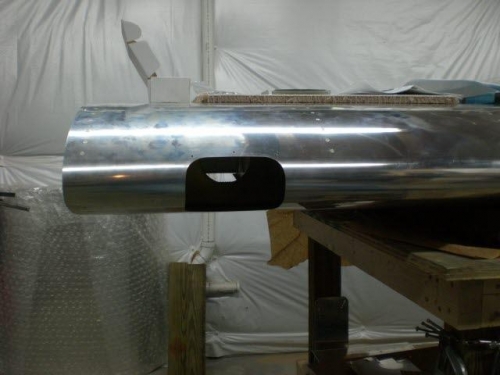

First thing I chose to complete is the right HID light. When I bought the kit it had HID lights for both wings. The left is already installed. I am installing the right side. The cutout in the right wing bay was already completed.

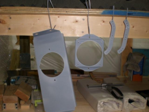

I started by reviewing the insrtuctions for quite a bit to get the process in my head. Then I marked and drilled the holes in the ribs using the template provided with the light kit. Then I installed the 4 10-32 nutplates into the ribs. Then I proceeded to deburr the light parts. As you may know, to do a good job deburring it takes time!!! Deburring is perhaps one of the most tedious parts of building.....and it is very repetitous....plenty to do!
After deburring and cleaning I shot the parts with the primer. That finishes this work session. It really felt good to get back in the shop :0)
Wing Cutout
Wing Cutout
Parts deburred and primed
