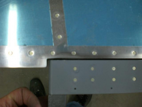

After putting the rod ends on I fit the elevators to the horizontal stabilizer. The spacing looked good and the position of the elevator horn in relation to the center bearing looks as though it will drill the hole in the horn that will give good tube clrarance.

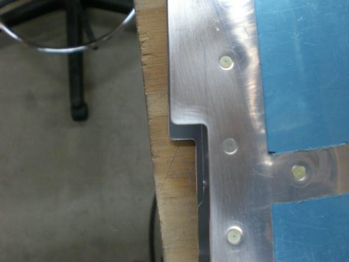

Next there was the removing of skin where the elevator counterbalance travels. There is not a lot to remove, approx a 3/4 X 3/8 piece. I drilled the inside corners with a 3/16 drill in order to give it a 3/32 radius. Worked very well....then I just cut along the lines with my dremel tool at low speed and it did a great job. Then the files and scotchbrite and there you have it!
Skin to be removed
Skin to be removed
Skin removed
Skin removed
Clearance checked...great!
