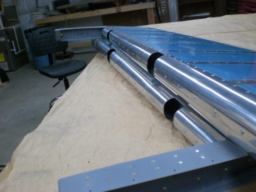

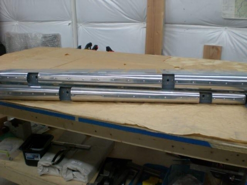

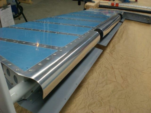

Brief Description:  Elevator L/E Rolling
Ok....so this wasn't all done during this work session......but I have other pics to put in the othe post. So just the same as the previous post pipe and duct tape. Of course it was "aviation grade" duct tabe from "Lowes aircraft supplies". Seriously its amazing what can be done without fancy machinery and equipment! A pipe and duct tape.....who'de a thunk it?? Anyway...the leading edges came out very nicely. Definately bending one section at a time and using two different size pipes was the right process.
I had to do very little massaging on the bends to get them right. When I rolled the leading edge on the rudder it was more than massaging.......it was CPR!!!!!
Half Roll

Full Roll
Full Roll
Double Roll
Double Roll
