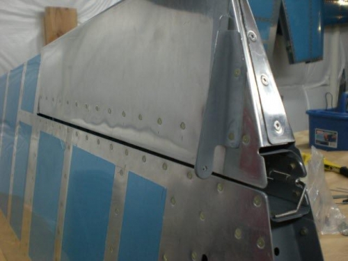

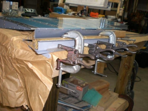

When I went to cleco the trim tab hinge on the upper skin and spar I found the skin holes to be misaligned with the spar holes by about 1/16 of an inch. This was too much to "pull" the holes into alignment so I clamped the spar and trim tab to the table and "adjusted" the spar till the holes matched up and could be attached without twisting the trim skin (see photo #1).

Re-aligning rivet holes in upper trim skin
Trim tab attached(note hinge pin in bottom right of photo
