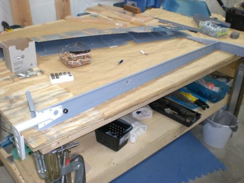

Date:  6-2-2013
Number of Hours:  2.10
Brief Description:  Left Elevator skeleton

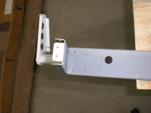

This was a real good work session. The skeleton went together very well with little problems. Cleco and rivet E703 to E704. Cleco and rivet reinforcement plates E610PP & E611PP to E702 Spar. Cleco and rivet E703/704 assembly to spar. Rivet WD605-1-L control horn to spar.
All in all it was a very productive work session!
Skeleton
Skeleton
Skeleton
Skeleton

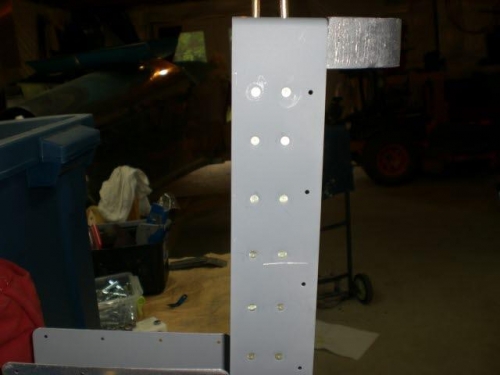

Counterweight assy wth lead weight
