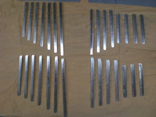

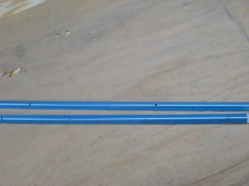

Began to work on elevators. Starting with the stiffners. There is a lot of work in these little items. They start out as a pre-punched angle and then the individual stiffners are cut out. Then there is cutting the long angles, and a lot of deburring!!!!!! I have found that the Scotchbrite wheel works best for performing the deburring. To cut the long angle I mark it with a fine Sharpie and cut close using band saw. I tried snips and razor blade scoring and snapping....but found that band saw was what seemed to be the quickest and worked best for me!
Stiffners begin as long pieces of angle
Here are the stiffners after much work

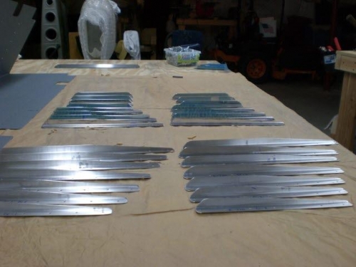

Table full of stiffners
