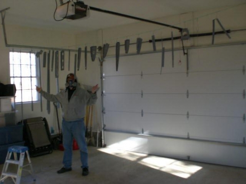

Ok.....after getting over the stupidity of the last work session, I got up and went back to work. This time on priming all the parts that have been fitted. I have been just fitting and preping all the parts then my plan was to pull out the spray gun and shoot all the parts in one fell swoop. Well as I prepared to do so, I went to get my wash primer and activator from the storage spot. Well to my surprise the gallon jug of activator apparently had a small hole and ended up leaking. Well long story short.....it was quicker and cheaper to get rattle cans of Sherwin Williams 988 etch primer and so I rattled my way during Prime Time. All parts done except elevator parts, which have not been prepped and fitted.
Now it is gonna be.....like the frog said..."rivet rivet rivet"!

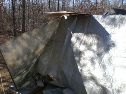

28 degrees...made a wind break
Parts drying in very toasty garage

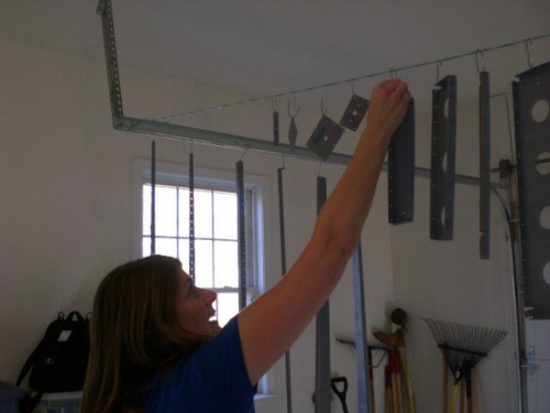

The best helper in the world made it easy!
