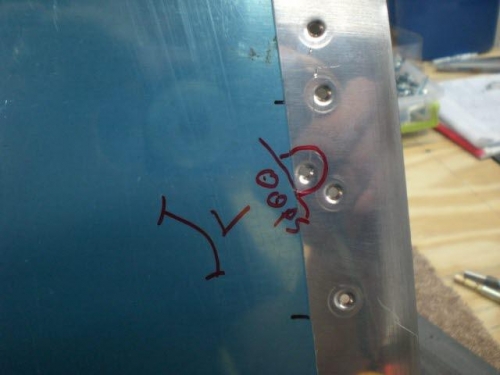

Completed work on left and right horizontal stab skins. Lots of time spent just finishing edges and holes. Dimpling the multiple holes in the skins can be very tedious. It can lead a builder to become a little careless due to the continuous repitition. Well I got a little careless and allowed the trigger of the pneumatic squeezer to be triggered and putting a hole where one didn't belong!
I made plenty of beautiful dimples....but put one extra dimple....ouch....I was able to repair it by putting a rivet in the hole to make it seem like it belongs there!
