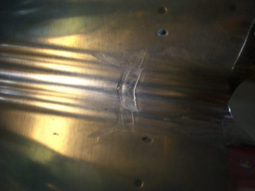

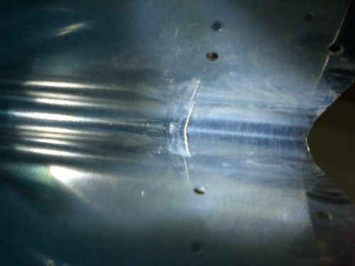

Brief Description:  Repair VS 801 Skin

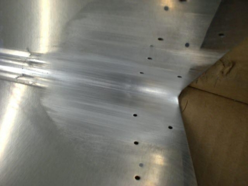

While I was taking HS skin 801 out of the shipping bos, I saw that another skin was damaged. The skin is VS801PP. It appeared that during shipping another skin sitting inside the VS skin was was not secured properly or became unsecured and began to chafe on the inside radius of the top edge of VS 801. I considered what to do. It looked worse than it actually was so I thought to try to repair it by blending the marred surface. After working with needle files and various grits of sandpaper and scotch brite it seemed to blend to a satisfactory condition.
Before repair
Before repair
Before repair
Before repair
After repair
After repair
