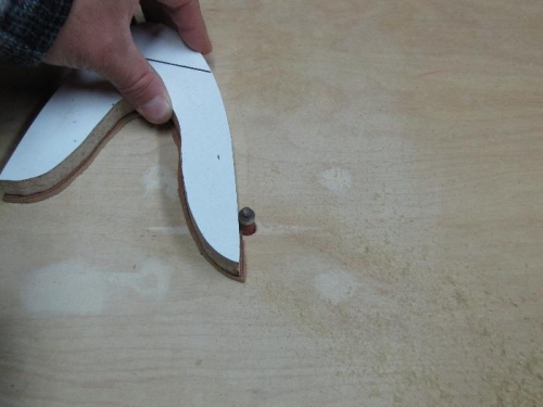

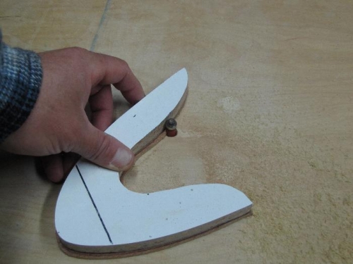

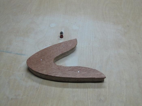

Brief Description:  Actually routered some nose rib gussets
Today i started the final shaping of the leading edge nose gussets. I nailed a rough cut leading edge gusset to the leading edge form. Then i turned on the router and followed the form with the laminate bit. After done i carefully pryed off the gusset from the form. It worked great. I checked the first one for a fit on the jig. Perfect fit. I cut several gussets tonite and will finish the rest tomorrow.
