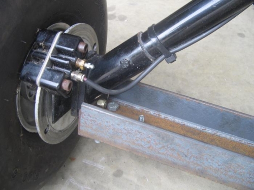

Had to make a bar to attach both gear legs together to stop the legs spreading when lowered onto the load cells. Worked well and W&B was successfully accomplished.
