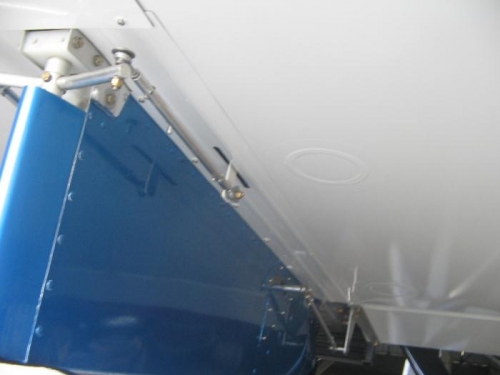

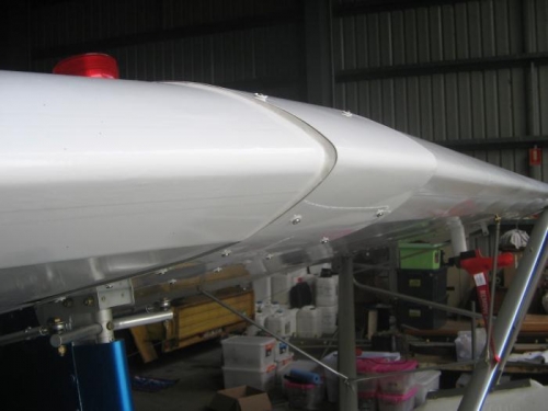

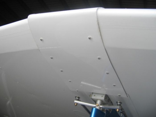

Fitted gap seals using M4 SS bolts with a plastic washer under the heads. Used white sicaflex as gap seal on front edge of upper gap seal and tthin weather strip for the rest. Used Loctite on all bolts to ensure they don't come loose and go through the prop.
front upper gap seal sealed with Sicaflex
left lower gap seal
left lower gap seal
