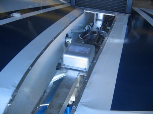

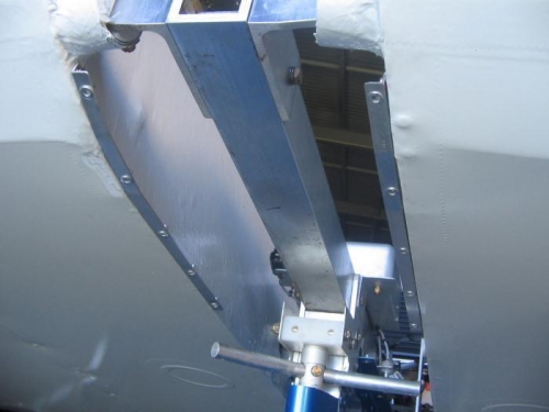

upper gap seal attach angles
Attached 12mm x 12mm angles to wooden root rib with SS screws to enable upper gap seal to be attached. Applied loctite to screws to stop them coming out and going through the prop.
