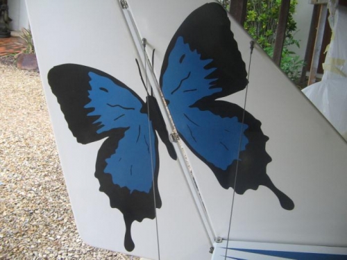

gap seals rudder and elevators

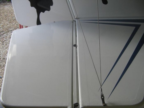

Fitted gap seals to rudder and elevators. Used same method as flaps and ailerons ie gap seal under hinges and fastened with silicone sealer to the leading edges.
rudder gap seal
left hand elevator gap seal
right elevator fitted to right stab
