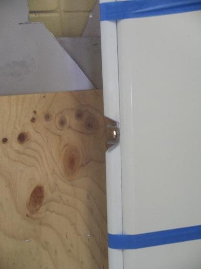

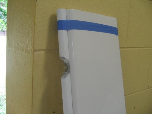

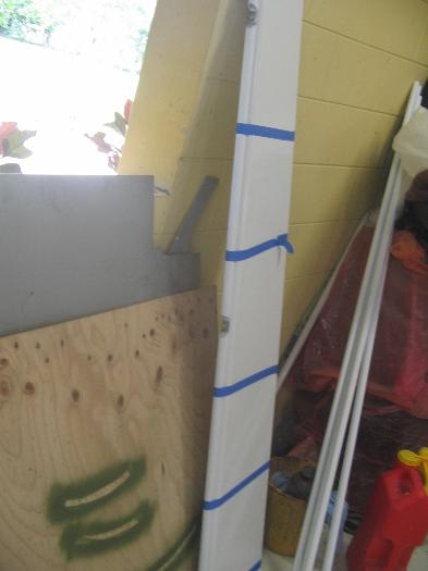

Fitted gap seals to ailerons & flaps. Instead of screwing them onto the leading edges as per the manual I fixed them in place by attaching them under the hinges and also gluing them on with silicone. This way there is no need to add additional spacing under the hinges and also no holes in the forward edge of the gap seal.
aileron gap seal under hinge
