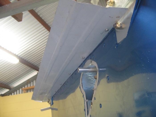

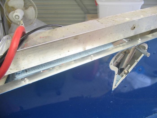

lower gap seals.
Fitted lower gap seals using M4 ally rivnuts and SS round head bolts as don't like the factory suggestion of using SS screws and tinnerman nuts due to their propensity to fall out and go through the prop.
rivnuts
rivnuts
bolted in position
