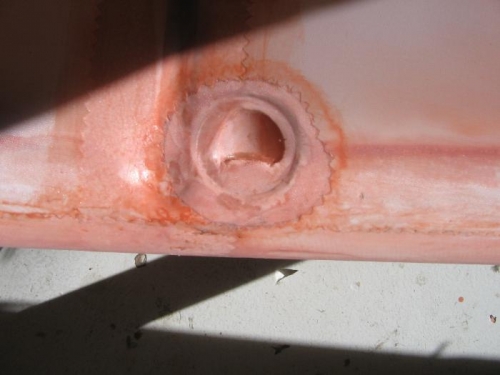

Glued on drain grommets at base of each rib with Poly-Tak and ironed down over trailing edge curve. Cut out doilys and glued over the top with Poly-Brush and ironed down at 250`. Burnt drain hole at inner rib as a grommet would get in the way of the gap seal.
