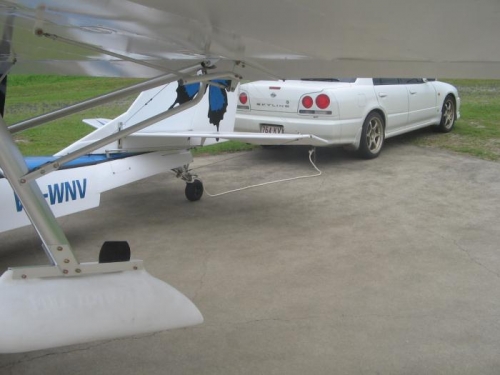

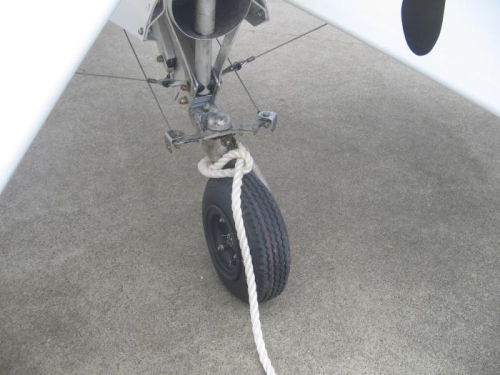

Secured aircraft tailwheel and conducted full power test to set prop pitch. First run max RPM was 5000 so adjusted the prop a little finer and achieved desired 5350rpm at full throttle.
rope around tailwheel
attached to tow hitch on vehicle
