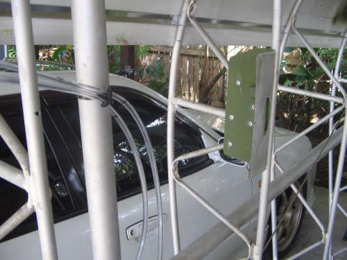

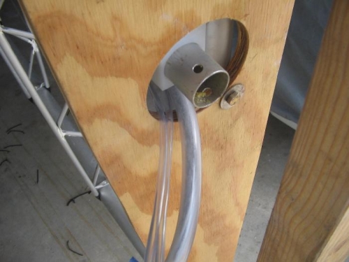

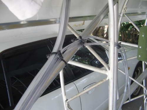

Ran clear pvc tube from pitot mount position to inner root rib. Used cable ties as stand offs to ensure no chafing will occur.
from pitot mount
cable tied to diagonal
exit through inner rib
