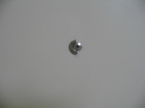

Fitted port and starboard static ports made from 6-8 SS rivets with mandrel removed. Glued on half SS washers behind each rivet to create a neutral pressure at the port.
