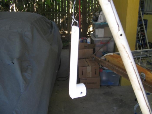

painting aileron horns
Painted aileron horns by etch priming with zinc chromate first then 2 pack primer and finished with 2 pack top coat.
aileron horn painted
