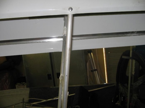

drilling rib holes for fabric attachment
Drilled 1/8th holes in top and bottom ribs on starboard wing for fabric attachment. Spaced holes 4" on top ribs and 6" on bottom ribs.
1/8th hole in bottom rib
