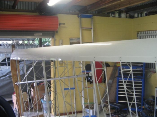

riveting on starboard wing cuff
Finished fitting wing cuff by riveting onto top and bottom ribs. Applied silicone to leading edge PVC pipe and top cuff support angle.

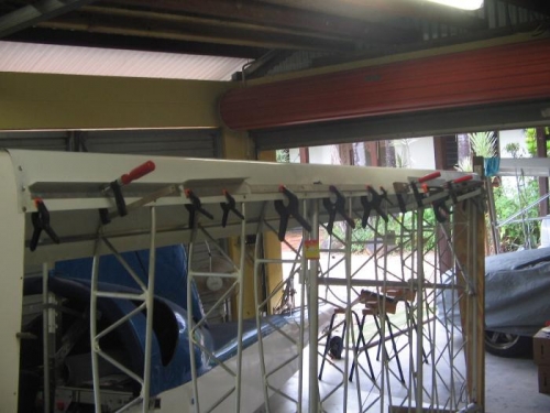

Fitted bottom cuff support angle with silicone instead of rivets like port wing. Held in place with clamps while drying.
cuff riveted on
