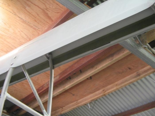

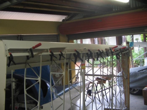

bottom starboard wing cuff support angle.
Made a bottom wing cuff support angle from 12mm x 25mm x 1.6mm ally angle to stop the cuff from dimpling when rear of cuff is bent down 45 degrees. Primed with zinc chromate.
support angles primed
attached to underside of cuff with silicone
support angle in position
