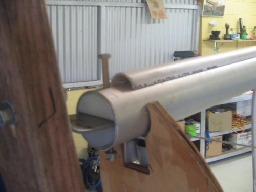

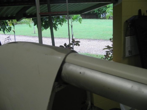

starboard wing cuff support
Fitted other part of 1" PVC pipe cut in half and fitted to leading edge of starboard wing for 2 reasons...
1. to stop bolt ends protruding through the leading edge and putting dents in the cuff
2. for extra strength in case of a birdstrike or hangar rash
wingtip end
inboard end
