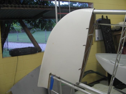

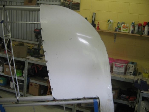

fitting starboard wingtip
Fitted starboard wingtip. Fitted aileron first to make sure of enough clearance between wingtip and outer edge of aileron. Aligned bottom of wingtip to lower wing ribs at compression tube position with straight edge.
bottom side
top side
