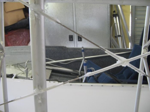

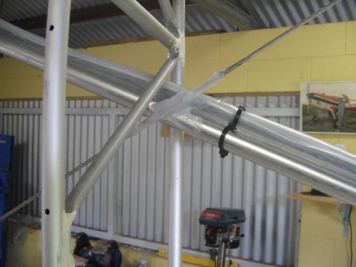

fixing internal wing support wire wear tubes
Cut and positioned the nylon wear tubes on internal wing support wires where rubbing could occur on compression tubes and wiring etc and siliconed them in position.
wear tube in position
wear tubes in position
