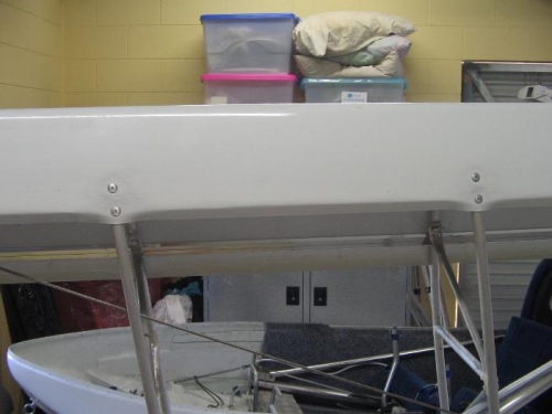

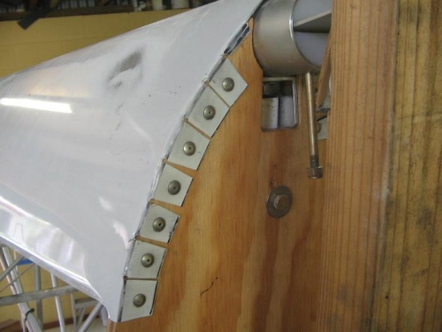

Fitted port wing cuff. First added a bead of silicone to top of wing cuff PVC. Clecoed in place then riveted rib and wingtip ends fist and then cuff to rib rivets. Bent rear edges of cuff down 45 degrees. Bottom cuff didn't dimple due to extra cuff support angle added.
rib end riveted
rib end riveted
rear cuff bent 45 degrees
hardly any dimpling in bottom cuff
