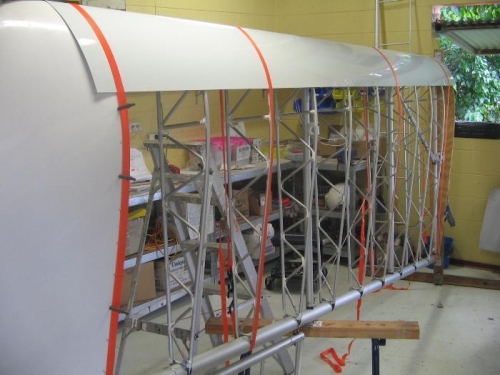

Held wing cuff in position with cambuckles and cut and bent inboard end for attachment. Lined up outer edge with rib andcut approx 1" in from end of cuff. Clecoed in position
Drilled 1/8th holes through cuff support angle and upper and lower ribs for affixing cuff.
cuff held in place with cambuckle straps

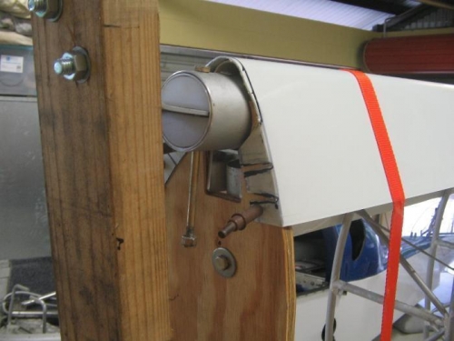

upper inboard edge bent over and clecoed
lower inboard edge bent over and clecoed
