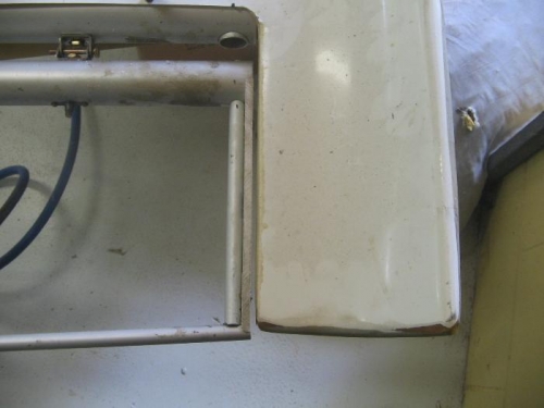

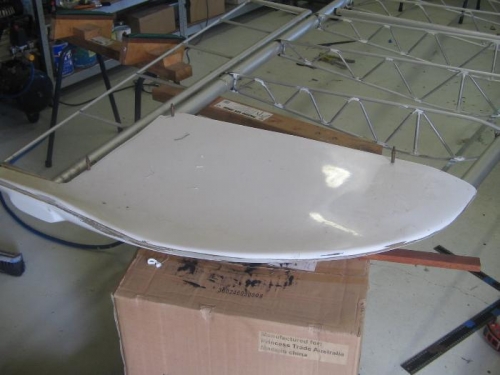

Fiited port wingtip. Fitted aileron first to make sure of enough clearance between wingtip and outer edge of aileron. Aligned bottom of wingtip to lower wing ribs at compression tube position with straight edge.
wingtip in correct position waiting for drilling and clecoing
even spacing between wingtip and aileron edge

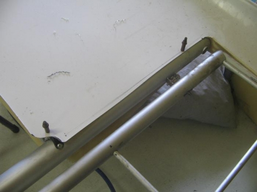

clecoed in place
clecoed in place
