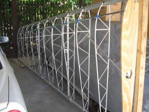

Brief Description:  fitting port wing trusses

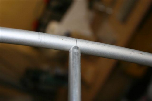

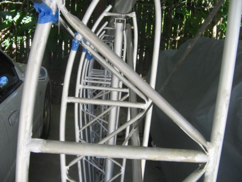

Fitted rib trusses to port wing over 1 week as each one takes 1 hour to fit including making up rib compression tubes in centre and leading & trailing edges. . Filed top rib end of compression tubes to wrap around rib instead of flat on round surface. Used marine Sicaflex under all attach points and ardrox on all rivets.
port wing with trusses
compression tube fitted
