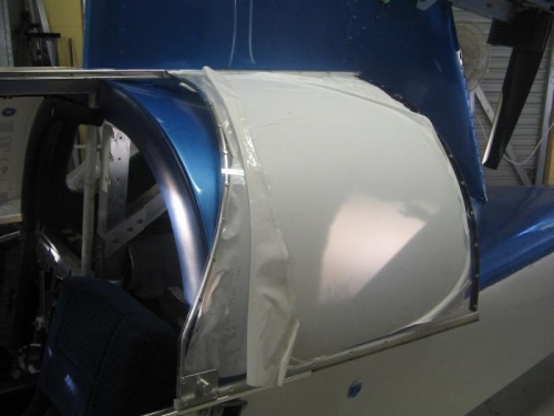

Finished riveting together right and left sliding canopies. Drilled holes in the Lexan oversized and used nylon washers under each rivet on the Lexan.
left hand canopy
right hand canopy
