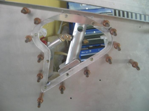

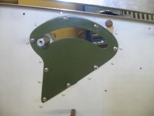

Once the side covers are fitted it would not be possible to service the flap horn area so I decided to add an inspection cover to the LH side cover..

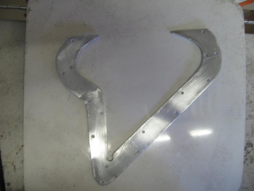

doubler
doubler fitted to side cover
inspection cover fitted and slot cut for flap horn
