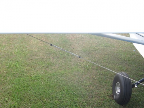

tail to wing cable anti chafe
Fitted plastic tube on tail to wing wires so it won't scratch off the paint when full flaps are deployed on the ground. Used silicone and cable ties to secure in position.
