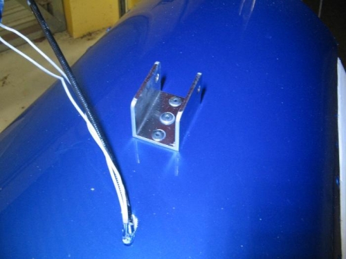

Brief Description:  trim mount channel bracket
Fitted channel bracket for trim actuator mount at rear of turtle deck. As there was a 3mm gap between the turtle deck and the top of the boom tube I made and fitted a 3mm ally spacer plate to stop the channel bracket crushing the turtle deck down too far and causing cracking in time.
Used stainless steel rivets and used silicone sealer in rivet holes and base of bracket for water sealing.
