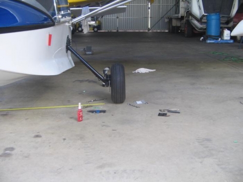

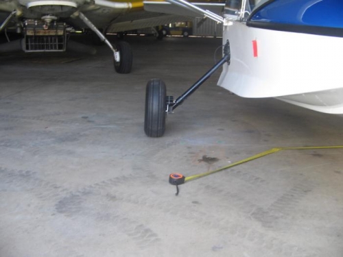

wheel alignment
Had to add a washer to each upper hub bolt on each side to decrease negative camber to (almost) neutral. Still has a little toe in but will test fly and see how it performs.
