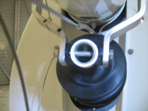

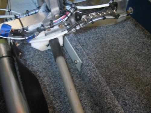

Installed elevator push/pull tube including doubler for aft horn. Installed rivet on top of doubler to stop any movement between the doubler and tube.
push/pull tube in situ

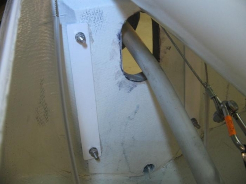

pushpull tube through transom
doubler fitted to rear of push/pull tube horn pivot bolt and riveted in position
