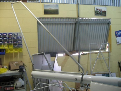

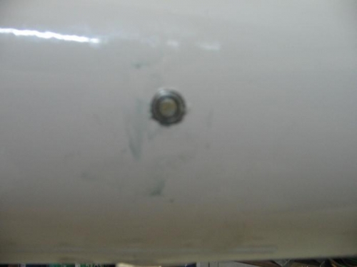

Fitted bush for elevator reversing horn pivot bolt and refitted vertical fin. Coated with Ardrox first and greased bolt before insertion.
elevator reversing horn pivot bush
vertical fin refitted to boom tube
