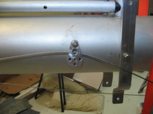

rudder assembly and pulleys fitted
Assembled rudder so that I could fit and adjust rudder cables and fit pulleys. Drilled mounting holes 915mm from rear of boom tube and attached RF418 pulleys. Rudder cable system works well.
rudder assembled and fitted
pulley fitted right hand side
pulley fitted left hand side
