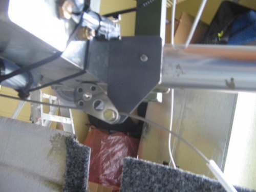

Brief Description:  Rudder cables/pulleys
Made up brackets to attach to lower bulkhead seat belt attachment bolts for RF418 cable pulleys. Frame had to be lowered into hull numerous times for adjustment. Also made up angle bracket for attachment of rudder cable over-sleeve to alleviate any angle of cable between rudder pedal and bulkhead pulley. Etch primed brackets.

RH rudder cable oversleeve bracket in situ
