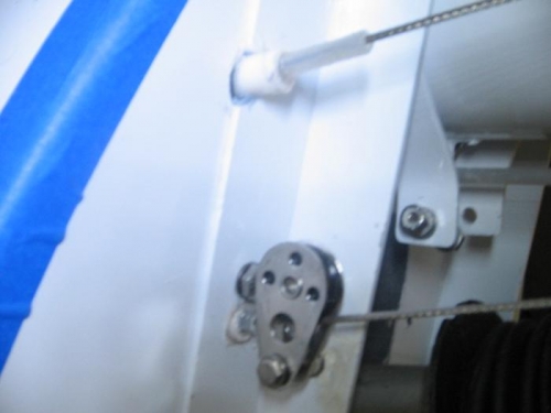

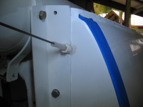

sealing cables through transom
Fitted larger diameter hose over nylon guides on cables and silicone sealed them at transom to stop egress of water into hull.
RH side rudder cable
LH side rudder & tailwheel cables
inside transom
