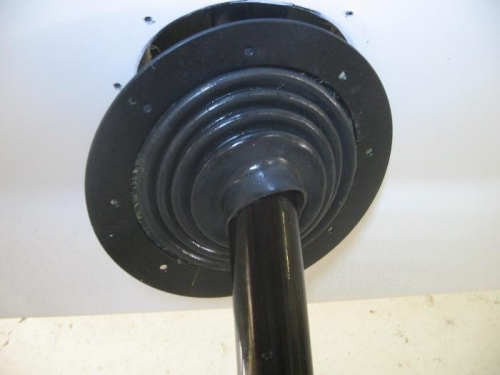

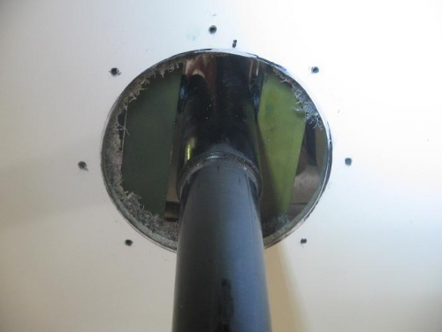

Glued gear boots to hull covers with contact cement and fiotted over gear legs before installation. Positioned and drilled holes for SS self tappers. Will leave unfitted at present as most likely will need access. When fitted properly will use silicone sealer around hull covers to ensure no water egress.
gear boot and cover
gear boot and cover
fixing holes for screws
