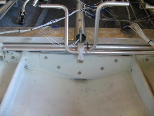

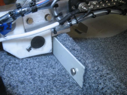

bolting frame into hull
Finally bolted frame into hull. Sealed all bolt holes with silicone sealer to ensure no egress of water into foam between stringers. Used SS bolts except for channel bracket bolts. Channel bracket bolts used are AN4-20a's.
left hand stringer with frame mounted
right hand stringer with frame mounted
forward stringers with frame mounted
