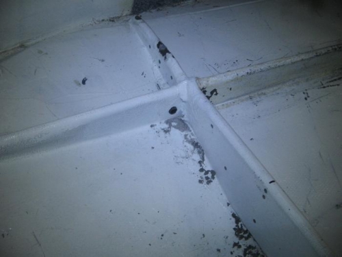

forward stringer drain holes
Drilled holes in side forward stringers to allow water drainage into centre hull. Used poly pipe to sleeve holes and Araldited them in place.

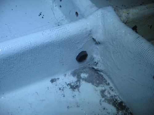

RH stringer drain hole
