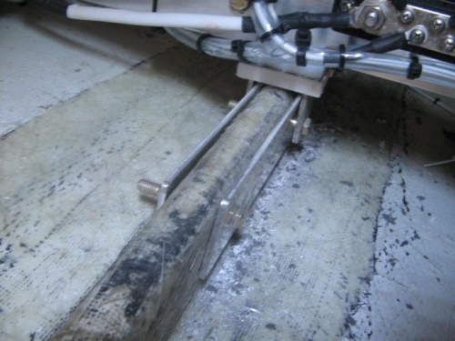

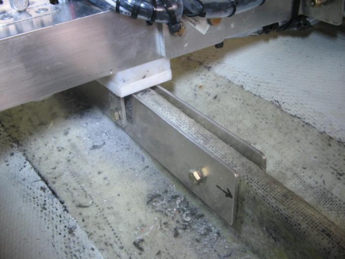

Brief Description:  rear stringer mounts
To spread the load of the pull on the rear stringers by the mounting bolts I have added 2 300mm x 50mm x 3mm plates to each side of both of the stringers. I find it hard to believe that anyone who bulids a Searey just bolts the hull into the hull using the stringers only with no other support as per the manual.
RH stringer support plates
LH stringer support plates
