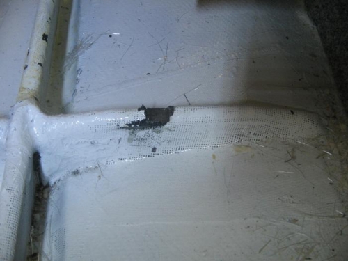

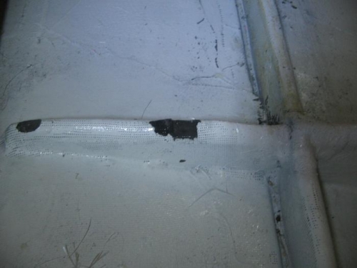

Lowered fuselage into hull and marked mounting points. Raised fuselage and ground away top of stringer so that channel bracket bolt heads are recessed and channel bracket is resting on the stringer.
RH forward stringer mounting point
LH forward stringer mounting point
