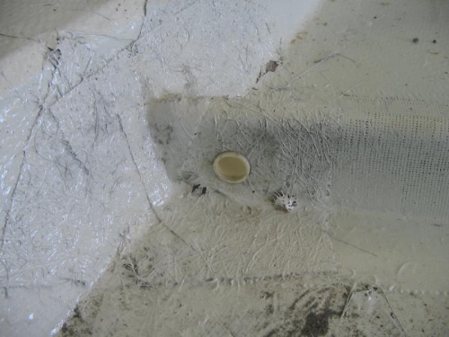

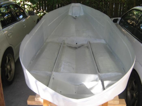

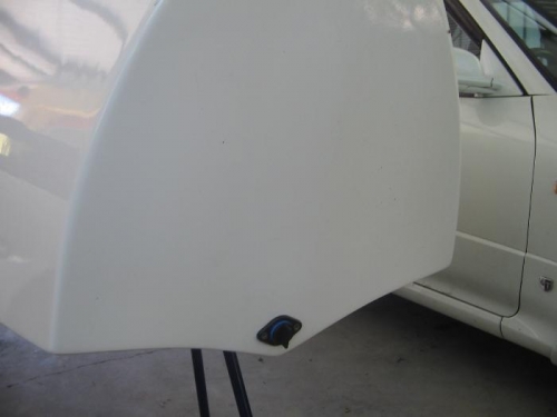

Painted hull interior with 2 pack light grey to make it easier to see in hull for inspections when turtle deck is fitted. Cut holes for bungs on transom and rear of ā€œVā€. Also cut holes in rear of inner stringers to allow any water to flow through to ā€œVā€ and out through bung. Coated all cut areas of carbon fibre hull with fibreglass resin.
